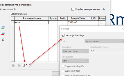

I have two needs with an implementation of a Room Tag...
  1. Show Ceiling type and height.
  2. Show Floor type and thickness.
Obviously this would need to incorporate 4 Parameters.
I know I can create two other parameters and have Dynamo concatenate and fill these values... but is it really the case that Revit cannot do this out of the box... even with a formula parameter?

Concatenation of parameters is not possible in Revit.
However for a tag this is not needed. A tag can have multiple parameters next to each other. You have to combine them in a single label, like in the screenshot below
Resulting in something like this in the tag

Any ideas how I can suppress the zero feet and zero inches and show only the fraction?

I found it I think...
Manage > Settings > Project Units
edit the Length Units... to Suppress 0 feet
Only concern is that this will affect Lengths in other places... this is okay I think however.
Any thoughts?

That is one method, but you also can do it in the label of the tag
