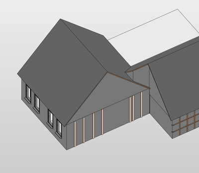

Hey!
please be kind with me, i'm extremely new with Revit and currently working on a Model for an old House of mine. I do have years of experience in Fusion360 for Hobby Projects, but Revit is quite new for me (less than a Week).
I have a bit of a complex Roof which i struggle to replicate in Revit. There is a normal pointed roof and a second Building which is rotated by 90 degree, a bit lower and offset by half the building length.
Here's a Photo of that Building and the Roof section which i struggle with:
I already managed to get this far by creating the 2 roofs Seperately and then joining them and attaching the Walls to the roofs:
My current Problem is, that i'm clueless how to remove the Roof beneath the other roof. I already googled for quite a bit but can't seem to find a way/solution to achieve this. I suspect it kind of needs to be done with a cut or trim?
Here's the Revit file of my current state: https://www.dropbox.com/s/vchd6qgegyhagzi/Fachwerkhaus.rvt?dl=0
Would be great if someone could give me a hint or show me how to create that Roof properly,...
Thanks!
Cheers Marc

Is this what your are trying to do?

Okay, so this?
Nachricht 6 von 15
apocalip
als Antwort auf: barthbradley
Yes! How did you do it :grinsendes_Gesicht:

well, you did close the Wall, but what i'm actually struggling with is connection/opening the Roofs on the Inside. I want the part of the Left roof, that is "under" the right roof to be gone, so there is a passage from the one attic to the other.
Nachricht 9 von 15
als Antwort auf: apocalip
Cut away part of the roof sketch then.

 To your roof follow the steps
Select the roof and Edit Footprint
1 - Select pick lines
2 - Select the exterior side os the roof 
3 - Select the line you created and uncheck the slope definition
4 - select Trim tool
5 - with Trim tool activated cut the lines to join in red
6 - with trim activated cut the lines to join in green
7 - Finish editing mode
Join both roofs

perfect, thank you!
