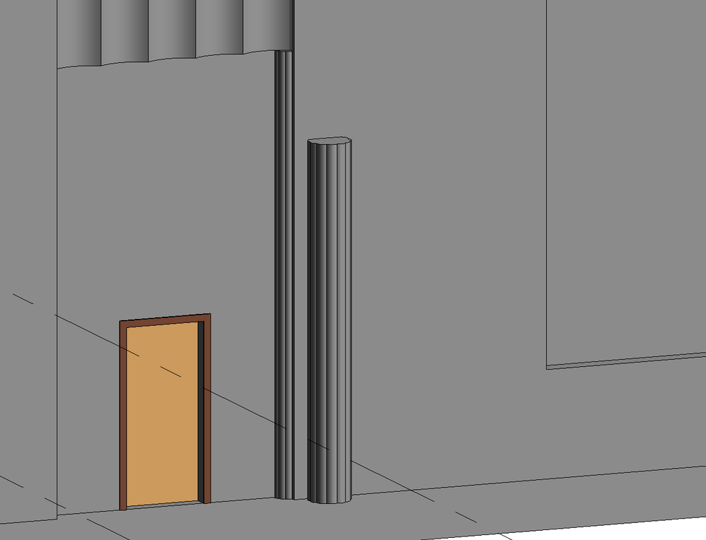

I downloaded a fluted column online which was constructed as a blend. I used the profile to create an extrusion. I did this because i need to increase the radius of the profile - i can't scale the import in just XY. Placing the new column next to the original, it shows that the new one doesn't accept the height parameters like the original does. New to revit so please feel free to correct any incorrect terms. How do I associate it with the desired level height?Screenshot 2021-04-03 145632.pngScreenshot 2021-04-03 145655.png

I resolved the issue. drag extents to top/bottom reference then click lock
