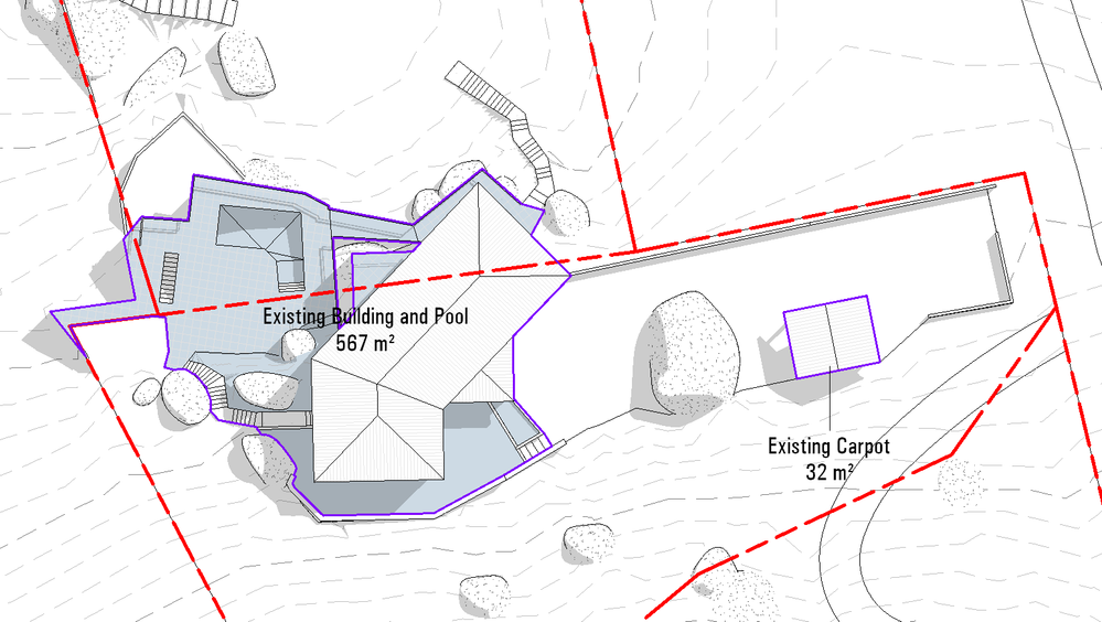

I am hoping that this is simple (but you never know with Revit)
I am doing a site area drawing however when i assign a fill to the various areas the fill does not "float" above the model elements but instead appears to be at a level inside the model and is being obscured by objects (see attachment).
Can anyone advise how I can make the fill "come to front" and all the model elements to the back?

Change the color scheme location fro background to foreground.

Thanks @ToanDN ! You're a legend. It did exactly what i wanted! Its so nice to have a simple elegant solution to a problem in Revit.
While I'm here is there a way to set the purple/pink area boundary lines to match the fill colour or better even be invisible?
Nachricht 4 von 4
als Antwort auf: Seychellian
Project wide: Object Styles > Model tab > Lines > Area Boundary
Per View: VG > Model tab > Lines > Area Boundary
