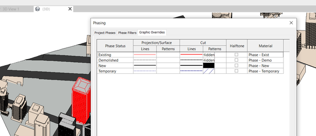

syman2000
als Antwort auf: eyalbRAPVR
One way I've done it would be to use phasing map to quickly change the link color. However this will mess up if you have phasing in your project. First I would add phase after new construction for link model.
When you are in the project, you can phase map the condition.
Afterward you change the graphic override and it will display as prescribe. The disadvantage is you cannot assign different color for each link.
My second method is to use the is worksharing display
When you turn on the workset, it will display in different color
Then you can customized the color to get what you want.
