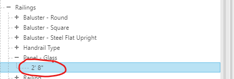

Do you know how can I make a colored glass railing for a mezzanine that I have? I'm able to change the handle material  but not the glass panel.

Create a colored glass material and assign it to the glass of the railing.

I dont have the option to change the glass of the railing, I already have created the material but I dont have to option to change it. do you know where is it?

Find out your glass railing panel family via editing Railing type > Baluster.
Then find it in your Project Browser > edit type > assign a new material.

Amazing!!! thank you so much!
