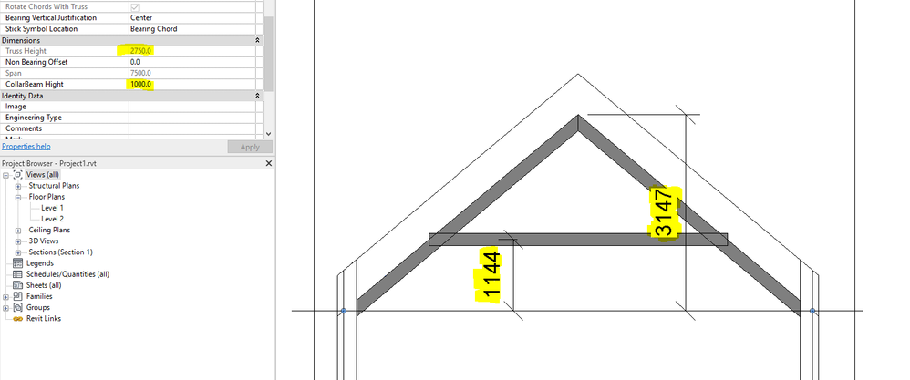

Before that - the truss. I am not getting it, I think that I am doing something wrong and cant get it to work. The top chord beams are going into the roof a little bit. I have set up a parameter to control tie height (distance from bottom chord to the tie), and it doesn't seem to work. Please see attached.

Your family isn't constrained properly. Check the apex.  Align and lock the TIPS of the Chord linework to intersecting Ref. Planes.

You are right, I must've break down the constrains when I was meddling with the family. All is good now. Except for the tie height. The parameter works perfectly when the truss is not attached to the roof, I think it has something to do with the Truss Height parameter, that is not reporting correct value while the truss is attached. It almost seems that it sets the value proportionately to what Revit thinks the truss height is, and not to what it actually is. Please see the fallowing.Not attached - correct heightNot attached - correct height
Attached 1 - values do not matchAttached 1 - values do not match
Attached 2 - when the value is set close to what Truss Height parameter report tie is close to real height of the trussAttached 2 - when the value is set close to what Truss Height parameter report tie is close to real height of the truss

It does work, but it sets the height at constant level of 1/3 truss height, right? While I would like to control it independent of truss height. For instance 1000 mm of the bottom chord.

I believe it has the same issue, the value set do not match value measured when truss is attached.Przechwytywanie.PNG

Ok, so eventually I have figured, that way easier way to achieve the goal would be to  use bottom chord as tie, and then extend the rafters to desired level. The downside is that structurally it is not a valid model, and length of the rafter is reported incorrectly. Scheduling Cut Length provides required information so for me it is acceptable.

The collar beam height reflect the dimension when the truss profile is not modified.  If the truss height is different from the roof height and you use Attach Top to match the roof then the collar height appears to be incorrect.  So the easy way to fix it is set the truss height to match the roof height then attach it to the roof.
