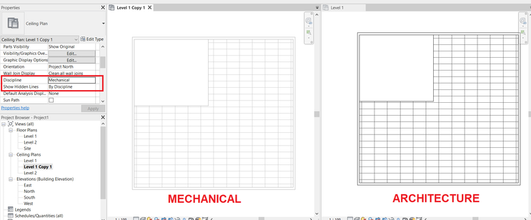

Can you check which discipline you are using?
As well check and see if your view range set higher than the ceiling display. As well check what underlay is set to. If you have underlay set and your view ranger is lower than the ceiling, it will show your ceiling as half-tone. If you change the view depth beyond the ceiling, it will show the ceiling as black line.

Nachricht 7 von 8
mlhier
als Antwort auf: mlhier
This is what my discipline and view range are set to. Neither of these seem to be the issue.
