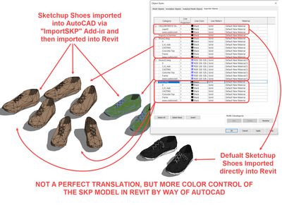

Hi Friends, I changed the colour of the floor material to white in SketchUp, however, after importing it to Revit it turns to gray. can anyone let me know how to change it to white? Thanks (please review the attached file)

Manage Tab=>Object Styles=>Imported Objects.

It just changes the lines. I want to change the material of the surface as it shows in the attached file.

Object Styles > Imported Objects > Change materials for the layers you want to change.

First thing is check the layer of that massing. Afterward you go into the Import category and click on the material. There change the material and you should be able to override the grey to whatever material color you choose.

I changed all the layers to white as you see in the attached file, but nothing changed.

View's Phase filter = Show Complete?

I did, Nothing changed.
