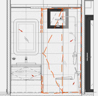

Good day, fellow Revit enthusiasts,
Today I stumped upon a matter I would like to solve, but don't know how yet. Would be glad if anyone can provide some further thoughts to look into:
I would like to change lines (material's pattern) behind the transparent families into dash lines. Is it possible?

httranlinh.kts
@imankassab2015
Actually I changed plumbing fixture elements to transparent, as shown below. The detail line is too manual and time consuming, which is unacceptable with a tight deadline unfortunately.

lucdoucet_msdl
@httranlinh.kts
A third alternative to @RDAOU solutions is to draft and constrain  2D lines to the geometry in the view. Then mask the 3D geometry, leaving only the 2D.
This isn't a good solution to your "time constraints" but has the advantage of following modifications to the 3d geometry when minor changes are made (ex. the wall is extended or reduced by a small distance). It will also accomodate the problem of partially hidden items like the toilet basin which will have geometry that is part hidden and visible. I would be a time consuming process for presentation drawings.

lucdoucet_msdl
@httranlinh.kts
I would also suggest that the more common architectural convention is not to show the objects behind the transparent material as dashed or greyed out in your case, but to make the glass wall and door (not shown?) 100% transparent with it's linework changed to hidden.
Here is what it would look like:
This could then be achieved by a view filter and remplacements in the view template. The filter would have to be able to identify your glass wall by some type name or other parameter. Up to you to decide if the panel next to the sink should be solid or hidden lines and adjust the filter accordingly.
To get the door to appear, you would have to model the door obviously.
Hope this helps,
-luc
