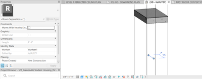

I am trying to see the room separation lines that I've drawn, they show when  I drag over them but disappear when I am in plan view. They seem to be way below the level I am working on. The room separation line (shown highlighted) in attached photo is below the floor, so I can't see it in plan. How do I adjust what workplane the room separation line is on??

Roomseparation lines lay on the level they are placed, and only bound rooms that are attached to that level.
No option for moving the line in the height, other that on another level.
You might not see the line in floorplan if a floor (or other element) Is higher placed than the level
