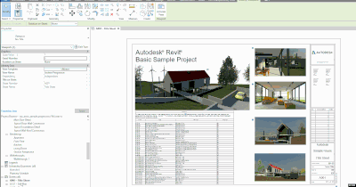

How can I edit or change the format of the view title? I also want to delete the number "9".

You will need to edit the Family for View Title - But check first if the family you are using has more than one type which might meet your expectation.
If not, then edit the View Title family used then add/remove any labels, lines, text notes you do not need - See GIF below
Edit: If you do not manage, Attach the view title family and tell what you want to edit
