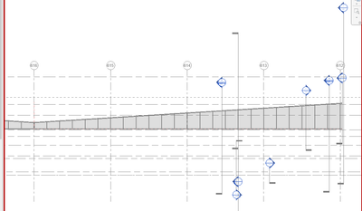

Message 7 of 8
lucdoucet_msdl
@real3dvision
The elevation view reveals that the wall has either a top constrained to a sloped roof (A below ) or has a profil. I suspect the former. These types of constraints are not highlighted by the Reveal Constraints view setting. The only way I know to check is to select the wall and using the detach function in the wall modify icon group.
So if you change the base elevation more than the height of the lowest part of your wall B>A, you will have a self intersecting wall profile which generates the error.
If so, detach the wall top constraint to the element above, change the base offset and reassign the wall top constraint after changing the roof height.
-luc
