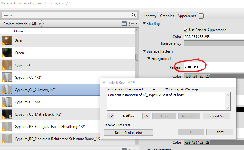

No option other than Delete Instance.  Are you kidding me?

Really?!? This issue (for ceiling based families only, face/work planed based not affected) has been here as long as i started using Revit.
- Create a tile ceiling
- Place a few ceiling based lights
- Edit the ceiling assembly, edit the tile material and change the surface pattern to None

Same issue in Revit 2019 and 2020.1.  Not sure about 2020.newer.

Hot Diggity Dog!  I did it!  2019.  Apparently it's fixed in 2020.2.
