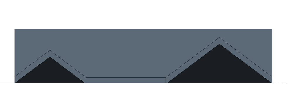

The Most Simple Gable (Revit File Attached)
The reference roof pictured below looks pretty simple. I was thinking I could model this in no more than 5 minutes.
It took me an hour and 15 minutes.

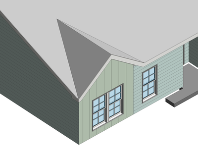

I've got 3 roofs: the main roof with a 1' overhand over the main footprint, and two gables. The gable on the right over the garage is no problem; a simple join. However, the gable on the left is what caused the slowdown.
Notice how the fascia board is flush all the way around and up the gable:
The main slope is a 5/12 and the gable is 9/12. Notice how the gable join at the corner of the main roof (left green circle).
Roof Dim's
I had to (despisingly) attach the wall below the gable using an edited profile and not the attach roof tool due to a roof join error.
The inside roof geometry is relatively accurate:
What is the best procedure to model this in the future? How long should this take a Revit modeler? How long does it take you?

What would you do to remove this part of the roof? It protrudes below the fascia board.
Using a void extrusion works fine to remove. No big deal to do that.
Is there a way to lower the right gable to match the existing roof? See how the fascia board does not line up (this is a big deal)?
Roof Valley not exactly in the corner, but this is probably close/accurate enough. However, having it NOT in the corner makes the fascia board work around much better.
I've never seen a roof made this way. This was a lot better/faster than my way and the geometry is much better. If the right gable cannot be lowered to match the main roofline then I would use a separate roof.

Since the right gable protruding out of the main roof so you can define slopes instead of using slope arrows.  See attached file.  That would clean up the details you pointed out above.
The result:
