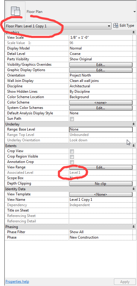

Are they Duplicate View of the same Level?

When you go to View=>Plan View=>Floor Plan=>uncheck do not duplicate view,  you see all those levels you are speaking about?
...What does their Properties say is the Associated Level?

Ya know that Floor Plan Names are not Levels right?  They are created based on the level...
Else we would have a giant mess of levels to try to filter out on the elevations.
Sounds like you just need to temporarily turn on certain categories in your view and change the overlay.

Only levels with plan views can be shown as Underlay.  If you only added the levels, then go ahead and create plan views associated with those levels.

Nope no flukes there...Just Underlay rules.
  1. For a Level Datum to be available as an underlay, it must have at least ONE plan view
  2. What becomes available on the Underlay drop down menu is the Level Datum itself (ie: Not the plan views created for that Level/Building Story)
  3. If for instance a Level has 100 floor plan views (ie: duplicate views), it would still be listed as ONE single LEVEL on the Underlay drop down menu (ie: Not 100 floor plans)
