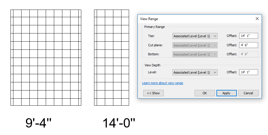

Please see attached PDF. How can I get the higher ceiling grid (14'-0") to show up in this view? I have tried to use a plan region, but I think ceiling grids use a different concept with view depths that I just don't understand. Thanks!

Change Top offset to 14' or more.

Hello @advandes,
set your View range as followed:
Or draw a Plan Region with the following View Range Settings:
That should do it.

I have tried that. I get the following error:
Error: View depth plane is set below the top clip plane.
I think ceiling grid view planes are upside down??

Thanks. Either way worked... Awesome!

...that's because it's backass-backwards with RCP view range...
