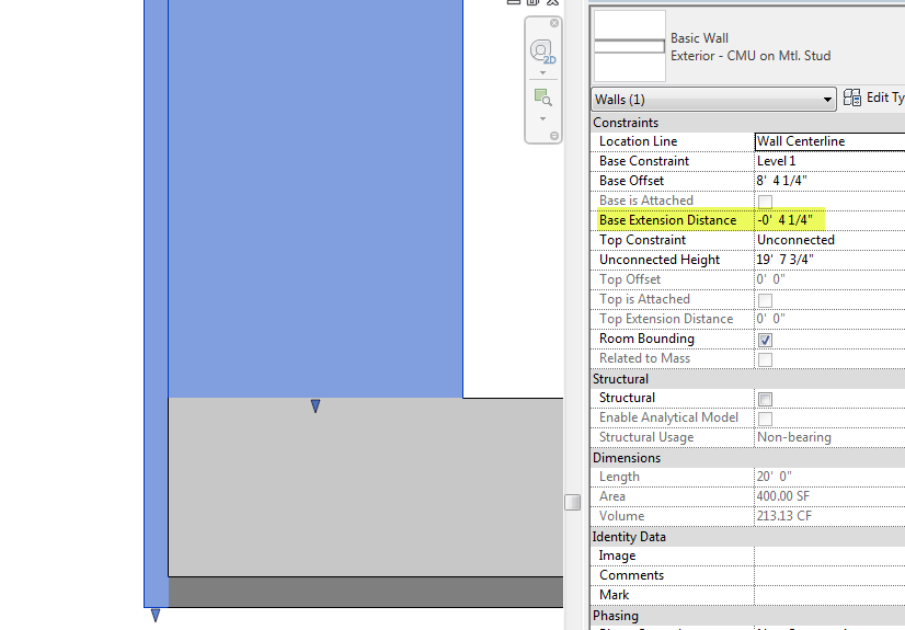

Message 12 of 14
David125
Base extension distance is greyed out and I've tried all kinds of different modifications to the wall, it stays greyed out. What am I missing here?
Message 13 of 14
You don't need to mess with base extension in order to have a clean soffit.  Use Join Geometry.
By the way, base/top extensions are set in the wall type properties.
Message 14 of 14
David125
It wasn't unlocking for me, I actually had to zoom WAY IN to that corner and it finally let me unlock it, thanks.
