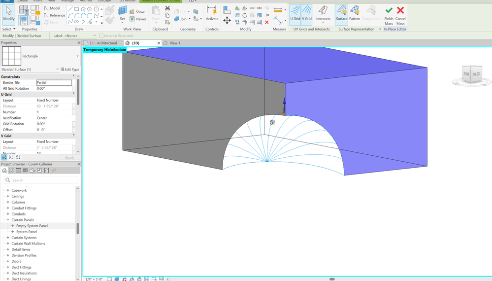

I followed what you are showing, but it gave me this message. Then I tried to modify the "divide surface" and select a pattern, but it does not look like what you are demonstrating. Could you tell what the issue is?f1.pngf2.png

I understand that we are using different units, but the current system is like revolving around a center. Do you know how to change the pattern so I will have them vertically?
Message 8 of 8
constantin.stroescu
The axis of revolution has to be horizontal and has not to penetrate the volume projection.... like in my screenshot.
Then , use Curtain System command.
Constantin Stroescu
