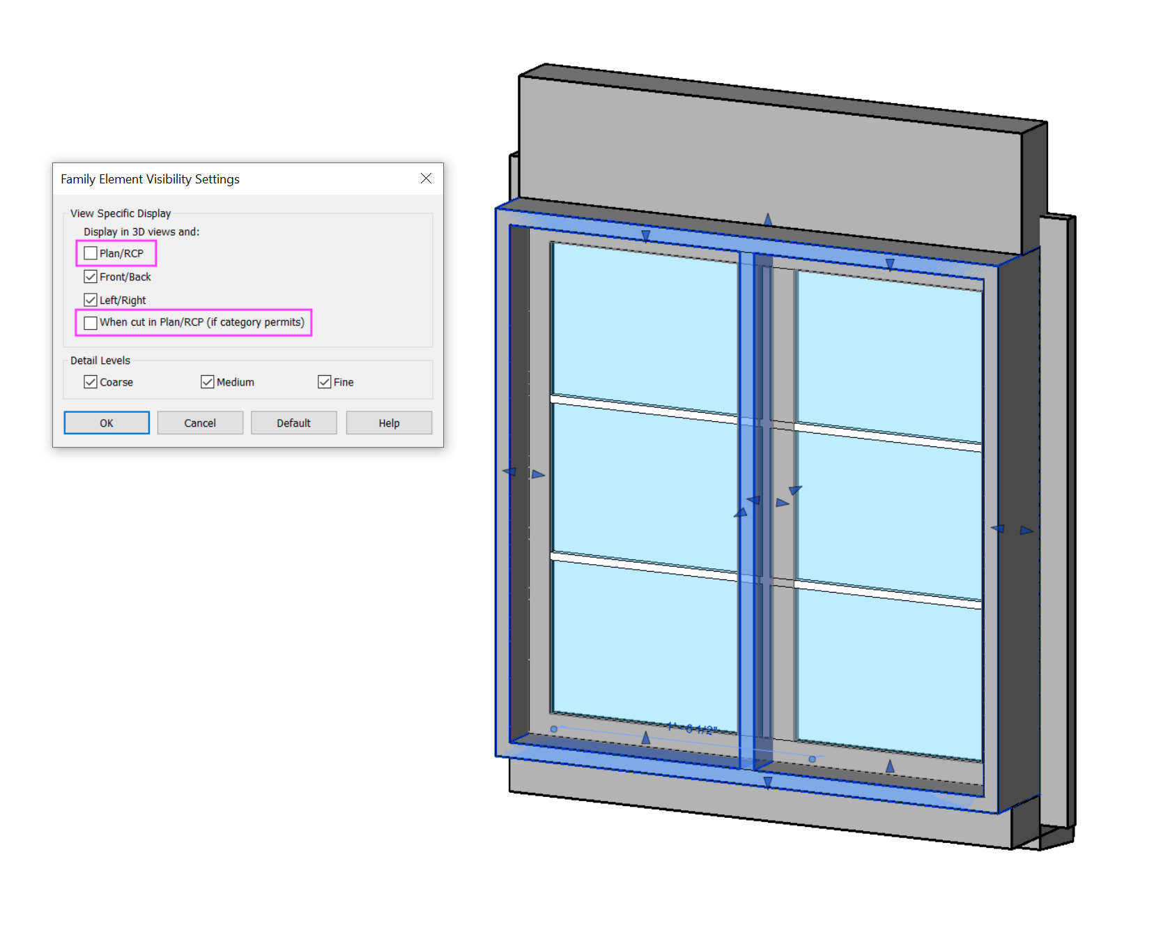

I cant get the window to show correctly in plan. I'm aware that windows obey the view range in the family, not the project, but I'm still struggling with this.
I want to have this center trim visible in plan, but it is not visible.
I believe I have it set up correctly in the family.
But this is what it looks like when I load it into project. The center trim is on a visibility parameter that is on, but I jus cant see it. I have the sills and headers as separate families, and I am aware that that can affect how it looks in the project, but even in wireframe I cant see the center partition.

Have you changed your view detail level?  Any change to plan?
Edit:  I looked at your family... see screenshot below, and check these boxes and reload into project... I think you will be good to go.
Nachricht 3 von 5
als Antwort auf: ChrisGamble
First and foremost, you have a Masking Region covering ALL the Geometry in Plan View...PLUS, Plan/RCP is unchecked in the Geometry's Visibility Settings.
FYI: Only 2D Symbolic Linework is Visible in Plan View.
 Turn on Preview Visibility in Family to see what's Visible when the Family is Cut and Not Cut.

Yea the plan region had a vis parameter on it to turn it off, and yea I check preview, it was the visibility wasn't checked in the graphics. Thank you!
