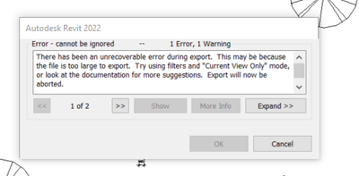

cant export to ifc after the new update from 22 of september

Hi ppls. I cant export IFCs after the new update. no matter how small the project file i get this error.
one of the things suppossed to be in the update is and update so it would be able to export/import IFC files of any size.
What can i do about it ? i have an assignment to turn in 28of september.. so HELP!!
tried to uninstall the latest update, but then revit chrases.

didnt work. samme error and this file is like 3 mb or something
