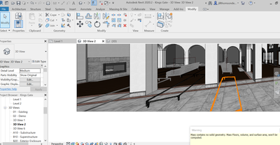

@barthbradley I feel like I am trying to do the same thing but something is off. I need to insert drawings from an online 3D model library, this company offers free conversions but doesn't have Revit. I only have Rhino5 and Revit. I want to apply materials to a few different areas. When I opened it in Rhino the layers are great! I down size the file and polysurfaces and import as a dwg. but then theres no mass?
What am I missing?
Nachricht 12 von 22
als Antwort auf: syman2000
I can't seem to separate the materials and assign them individually or they stay gray. I seem to be missing a link. I am importing files from turbosquid and converting from rhino to dwg, saving as family, changing materials. I have tried to import small pieces, change colors. Please help :benommenes_Gesicht:

I looked at the CAD. It seems like there is no mesh. Also since the object is set to one layer, you might as well create layers and place the object in the layer. Revit will only split material base on layers.
