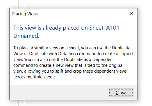

I've been working with phasing in Revit. I made a duplicate (with detailing) of my floor plans. I tried to place these floor plans on the sheets but when I try to drag them to my sheets some of them can not be placed. Unfortunately I couldn't figure out what the cause of this problem is. Any help would be appreciated. Thanks in advance.

The ones already placed on a sheet cannot be placed on another sheet.

When you say some you could not drag and drop on the sheet, implies either of the following:
  • You are trying to drag and drop the View onto another model/drafting View (No prompt is displayed and nothing happens) => make sure the sheet is open on your screen, then from the project browser, drag and drop those views on  to the open sheets
  • You are trying to place same view on multiple sheets and in such case Revit must have popped a prompt message up explaining why you cannot place it on the sheet and the message should be fairly self explanatory...IF you didn't see that prompt (image below) then it must be case 1.

Thank you all!! I just find a way to insert the floor plans in the sheet. Instead of dragging it into the sheet I added it in the sheets with the tool 'add view to sheet'.
