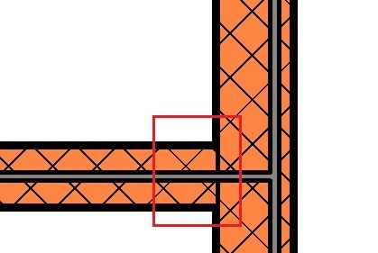

there is a possibility to cancel the line between wall mark in the pics?
File is attached.
Thank's

Although they look same, but you are using different materials. Unify the material then they will join correctly.
You are using some times Laterizio (6) and sometimes Laterizio (5) and Laterizio (4)

You need to combine both posts above if you want no joint lines: same material + same layer function.

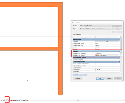

@Anonymous : another approach would be to have the same course fill and pattern for all your walls, and set the view to Course Detail Level.

Does he not have several laterizio materials? If so, there will be line between them. I didn't open his file so it is a pure speculation.
Nachricht 7 von 7
als Antwort auf: ToanDN
Yes he does. Several of them. All custom. All different.
...the issue is just with the Assembly.  This is how the OP had it:
