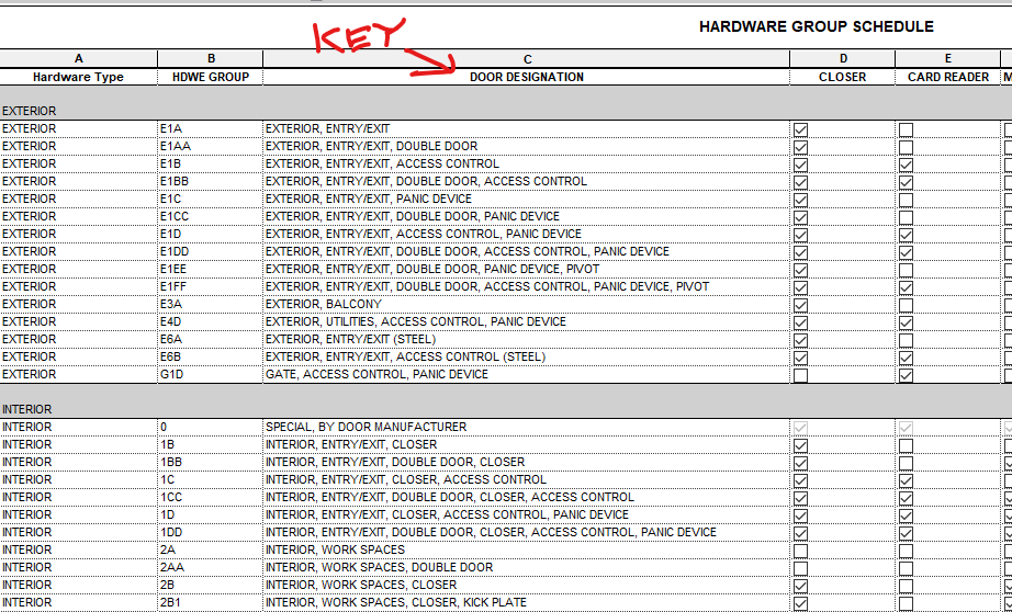

RGurcheARD9D
als Antwort auf: barthbradley
THANK YOU BARTH. THE LINKS HELPED BUT I NEED A DOUBLE REFERENCE INSTEAD OF THE SINGLE REFERENCE IF THAT IS POSSIBLE. SO WITHIN THE HARDWARE SCHEDULE, I CAN LINK THE HARDWARE SET #, HOWEVER I WAS ALSO WONDERING IF THERE IS A WAY TO HAVE ANOTHER FIELD ASSOCIATED WITH THE HARDWARE SET NAME SO WHEN A PERSON SELECTS HARDWARE SET 1, THEY KNOW ITS THE CLOSER HARDWARE SET. OR SHOULD I JUST COMBINE THE HARDWARE SET NAME AND NUMBER?

Use a key schedule. But instead of using numbers for the keys, type in the description of the hardware, and add another field to type in the set number.
