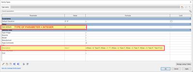

Maybe you can use something similar to this approach to get there:

@barthbradley probably quicker to just type the description then using if formula with 100 of iterations when trying to input a size of object based on 2 parameters ie "X x Y". but suppose your solution would resolve.
Would be handy if could input something like parameter X() "x" parameter Y() whereby the () part would use that parameters value
