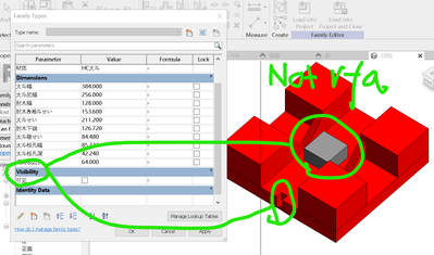

can visibility be set for geomertry (not nest rfa) within a famly?
hello,
within a family there are 2 small parts need to be set to visibility yes or no, can it be achieved? or must nest a child rfa again ? (not preferred cos I don't want too many levels of constrain-ref as many persons will operate it)

Sure you can. Each element's visibility parameter can be associated to YES/NO Parameters in the Host.
Your question does  make me wonder though, because  it is something quite common in a lot different Families.
Many Family TYPES are created just by turning ON or OFF components that ate not a part of one TYPE but part of another TYPE.
