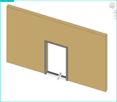

Hello, I created a family recently and then I loaded it into another project. I am unable to rotate it in the project.
Any solutions ?

talha_ozdemir
Hello again, the family template is generic model. And I am also
uploading the family, it is very simple family profile for the window panels.
I created this family and uploaded to the host family, I am also uploading an image
so you can take a closer look.I constrained family to the bottom of the panel, and I also
need to constrain a copy of it to the top part, but before doing that I need to rotate the family. It
should be just a simple task, but it wont let me rotate.

If this family was supposed to be used in different orientations, you should have planned for that, either making the family face-based or making two versions of the family, one for each orientation. The face-based would have been the easiest solution. The second solution is not difficult either.
Another solution, more involved, is to make this family work-plan based and use another intermediate family (after this one and before the host) to create a rotation parameter.
Message 5 of 12

Family by default cannot rotate in z direction. So you have to set it to work-plane base
In the project you create a reference plane and give it a name
Host the family on the reference plane and you can rotate it by rotating reference plane.

Are you saying that you want to rotate this family in a Host Family, as if it were hinged on one side?
....if so, make the nested Family a Work Plane-Based Family and then place it on a Ref. Line Work Plane in the Host.  Control the Rotation Angle of the Ref. Line via a labeled dimension in the Host.

I take that you need to use the same component for base and head of a panel.  If so, tick Workplane box in the family as you have been advised then you can host it on the base and top reference planes, without having to rotate anything.
