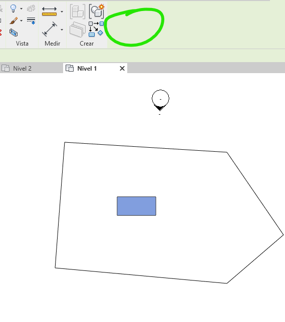

I've created a new pad.
But something weird is happening. I can't select any pads to edit boundary. (See attached).
Also - when I 'Hide Category' for Pads - some disappear others don't. I've checked phases also.
In image I've switched everything off except pads.

I'm actually not selecting the Pads but the toposurface beneath it.
I can see & select Pads in 3D view, but I can't see or select some of them in plan view.
for some reason.
But I've created two sets of identical pads to go with the toposurface(s). i.e.
One set of pads & topo for exist & another set for new construc phases.
Otherwise from experience the pads get tangled up between the different toposurface phases.
Maybe that has something to do with it?

Solved it!  -
View range - the other pads were 10mm lower - that's why I couldn't see them in Plan ....

Use Tab to cycle between topo and pad when selecting. Or do a cross window selection, then filter out topo.
