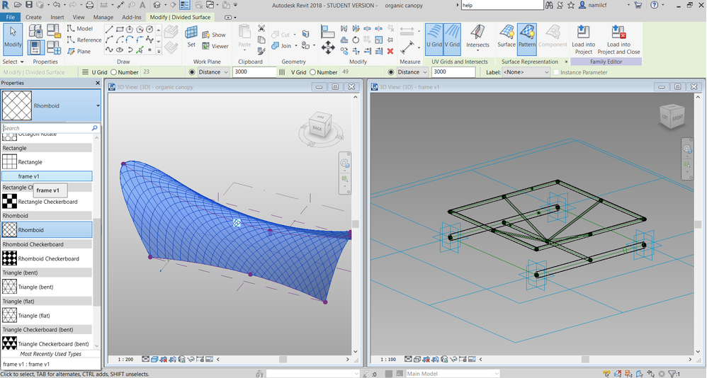

Hi there,
could someone kindly assist me please.
i 've done saved the family file created from Metric curtain panel pattern based.
In the mass model file, after i chose the surface to customize, then at the Pattern "pull-down",
i can see the new file right below Rectangle.
however, after clicking this new pattern, the regenerating failed and produced long list of error,
as provided by the screenshot.
Could anyone kindly explain what went wrong & how to fix it please.
Many thanks.

You pattern family is not constrained properly.  When you create family like that, always text it by flex the grid dimensions before loading it in project.

A wild guess...looks like you have been following a youtube tutorial (EXAMPLE: THIS TUTORIAL)
Considering the resemblance, I would suggest that you go back to that tutorial and follow step by step

Hahhaha you're right.
however it is not fair . he gets it and i did not.
i am sure i did exactly!
guess i just need to try again.
:leicht_lächelndes_Gesicht: well he is the creator .
Nachricht 6 von 6
als Antwort auf: ToanDN
Thanks for the big help!
Haha  you really have sharp eyes.
OK i get your point.
let me try re-enter the constraint .
Cheers buddy.
