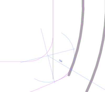

I keep getting a lot of "Can't change radius" errors when using the fillet command.
In this sample, the radius that I'm trying to add is not very small. (250mm).  It is driving me NUTS!  It happens with almost every circular fillet.
Any ideas or hot fixes for this?

While you have the "Fillet" command active, look at the "Options Bar" docked below the ribbon (sometimes docked at the bottom of the interface window). There you will see a check box for radius where you can set a number. Whatever number you enter in this section is the radius that the "Fillet Command" is stating that it "Can't Change'; which further means, this is the radius that will be used to automatically complete the fillet radius on your drawing.
The TRICK is !!!!  - you must check the checkbox and enter the number for the radius FIRST!
before you click (choose) the lines or arcs you wish to fillet. Afterwards, all you need to do to complete the command is press "Enter" or click within the specified radius on the screen.
If you choose the lines first before the manual entry of the radius at the Options Bar, you will still end up with the error "Can't Change Radius".  See screenshot.
