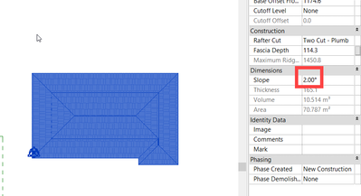

Can't assign 2% slope to the roof
Hello Friends,
I can't assign a 2% (1.15°) slope to the attached roof. Does anyone know why and how to fix that? Thanks

I don't have this problem
  • Look at the Project  Units settings
  • and maybe to Snap

Have you assigned 2% to all lines?
Nachricht 4 von 18
als Antwort auf: Anonymous
Try 5% in sketch mode, finish and close, and then select the roof and change 5% to 2%.

it looks that your roof is too thick for this slope. If you make it thinner it will work..

Yeah. Revit didn't like it.  I put in 5%, finished out of Sketch Mode  and changed the whole Roof to 2% under its Properties.

It is 6.5" which is our standard. I can't make it thinner.

I can suggest you are trick to overcome it...
  • Make a Roof ,for instance at half width of the desired thickness, or split the Layers
  • Copy this Roof to Clipboard and then Paste Aligned to Same Place
  • Move the Copy upwards and Align the bottom with the Top of original roof

Just select the Roof and change the value for "Slope" under its Properties -- like is shown in my screenshot above.

2% ain't 2 degrees.

I see you are using 2009. I was testing your file with 2020. Maybe 2009 can't do it. Dunno. I'd just go was @constantin.stroescu 's suggestion.

Here is the one that uses the original roof type.  For this type of slope, I would assume the structure be flat and only the insulation/roofing be sloped.

Never mind @Anonymous.  I was testing using your Project/Roof units.  Never occurred to me to verify the units.
