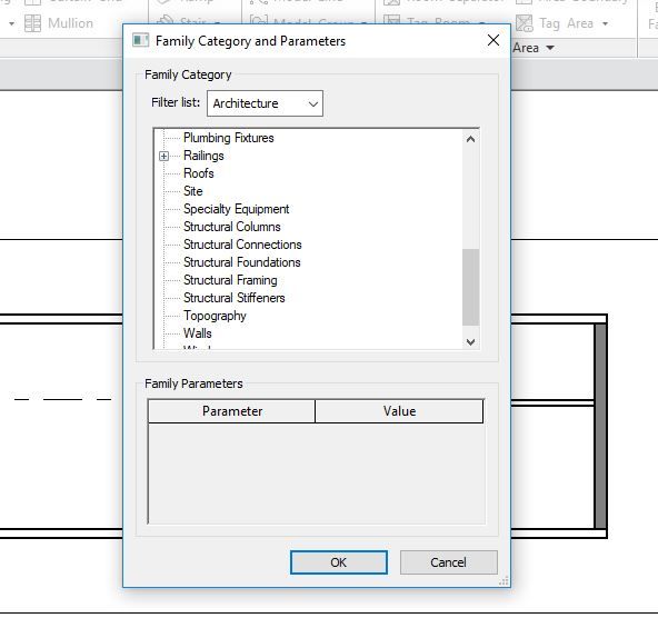

Hi there,
I am following a video to draw the stairs. But when I click Component - Model In-place. The option of 'stairs' in the family category and parameters is missing. How can I find it out or create a category of stairs?
Thank you.

The stair in place is added quite recently, which version are you using?
You can also use a generic model in order to draw this stair. It will not change your workflow.

I'm using 2016 version, this is probably the reason why I couldn't find it.
Finished it by using a generic model! Smiley (überglücklich)
