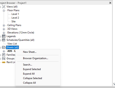

Is it possible to create a sheet in a Revit family file?
I would like to create a drawing of the family object, and it would be preferable not to place the family in a RVT project first as the client have strict file structuring guidelines.
In the family's project browser, I do see "Sheets (all)" listed as a category, but when I right-click it, the "New Sheet" option is missing.

how about right click Sheets (All)?
Nachricht 3 von 10
Thank you for your response.
Your example shows the Project File (RVT).
Please see my screenshot in original post.
I am looking to create the sheet in the Family File (RFA).

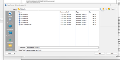

or you need to create a new title block family >
then title block
then load into your project?
Nachricht 6 von 10
Thank you for the response, but once again. Not what I am looking for.
