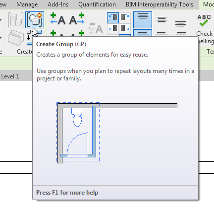

Group the text and place Group in View

I didn't say anything about pasting. I said Group the Text in Sheet View, then open a Model View and place an instance of the Group.

Do you know how to GROUP?  Create a GROUP of all the text and then go to a Model View, select the Group in the Project Browser, right-click and press "Create Instance".  Place GROUP instance in the View.
