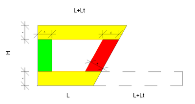

I try to make some calculations with reporting parameters, but I can't get it to work. Does anyone know how to get around this problem? I know I can do these calculations in a list in the Project but I like to do it the family.

You can find a reasonably simple formula, by subtracting  areas from the original area.
original area:  H * ( 2L+Lt)/2
yellow areas:   ( 2L+Lt ) * x
green area:      (H - 2x) * x
red area:          (H - 2x ) * d, where d / x = sqrt(Lt^2 + H^2) / H
In the original parameters:
(Bredde - 2 * Tykkelse Yttervegg) * ((Lengde + Lengde Triangel / 2) - Tykkelse Yttervegg * (1 + sqrt(1 + (Lengde Triangel ^ 2 / Bredde ^ 2))))

Nice, @FAIR59.  Dead-On-Balls-Accurate!  You win!
Message 23 of 24
WOW! Thanks alot to both of you! This is excatly what I'm after.
