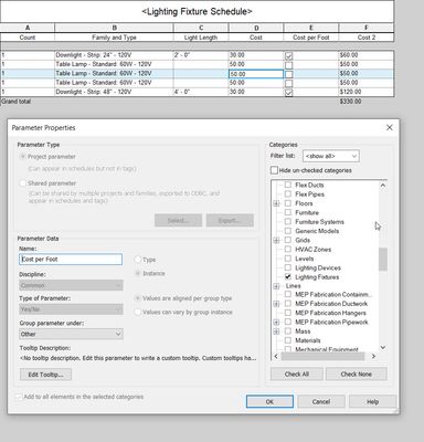

I am a lighting designer new to Revit and I would like to make informative schedules showing the cost of the luminaires.
So far so good.
The problem is that linear lighting  is priced in running meters. When I add linear lighting in a kitchen for instance, I add one piece on linear lighting  (thus counted as 1 in the schedule), but it might be 3m long and the price will be 3 x cost/m. In the same time I will add some other lighting that is non-linear and is priced pr piece.
So this is the situation:
I would like to do something like the following, but dont know what kind of formula I should use:
The thing is to get the prices for both linear and non-linear lighting in the same column.
Any tips?

I think you could use a yes/no parameter to define linear/non-linear, or a calculated lenght value. Needs a value otherwise when it doesn't have a lenght your if statement will not work. You could also have the cost calculated within the famil(y)(ies) as shared parameter to schedule directly.
In any case you need another parameter there...

Use this formula for Calculated Cost:
if (Length >0, (Length / 1m) * [Cost per meter], Cost)
- Cost, Cost per meter, and Calculated Cost are Number parameter for simplicity.
- Nonlinear fixtures should not have Length value, or = 0.

I'm done playing with it.   A Calculated Parameter using a conditional statement to evaluate a Yes/No Project Parameter is the way to go.

This worked great!
