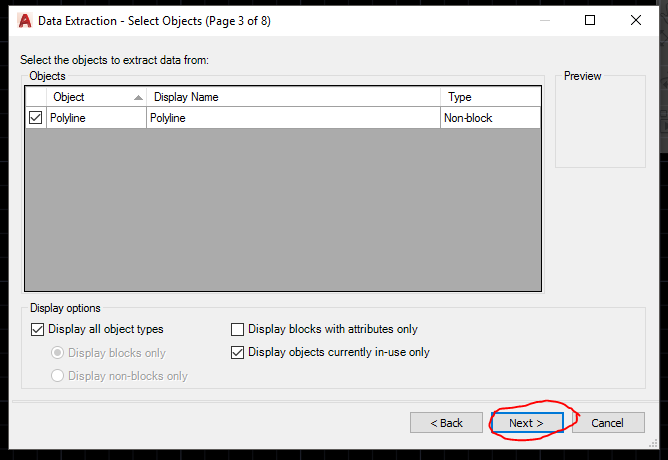

- Attach the PDF in AutoCAD and scale it to true size, not paper size
- Draw a closed polyline follow a typical leaf (if it's a vector PDF then you can snap to the geometry, otherwise, just eyeball it)
- Copy it allover the elevation
- Run Data Extraction:
Nachricht 14 von 16
als Antwort auf: ToanDN
Thank you for the detailed step by step. Please see those screencasts. What I ended up doing is, "delete everything but the leafs" then used your method "Data Extraction".
1. On the first screencast, I was not sure about the what you meant by scale it to size? I think AutoCAD detected the scale of 1:1 which is correct, yes?
2. You wanted me to use the polyline for a leaf, problem is I have different leaf sizes, so this is time consuming unless I misunderstood what you suggested!
3. As I said above, what I did was delete everything but kept the leafs then used the data extraction for polylines, arcs and spline. Is this approach accurate?
The second screencast shows problem with unit measurement, please advise how to fix this.
The PDF is a drawing sheet, the elevations are scaled to fit on it (e.g. 1/8" = 1' or 1:100, etc), so you have to scale it up to the true size of model objects.
If you could use the geometry converted from PDF to AutoCAD too measure length, but if they are not closed polylines then you cannot measure areas.
That is a good first step.  But you need to make sure each leaf is a closed polyline in order to extract the area.\
Another option is use Data Extraction to report Length only.  And, create hatch by pick point inside each leaf, hatch will show its area on the properties.

I fixed the scaling issue. I had to insert the PDF as a block then used the Scale command. Next, I will be trying the Data Extraction method you suggested to get the linear feet of the leafs. I will keep you updated.
