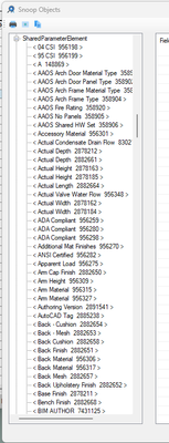

Sorry, I didn't mean to confuse.  I'm not using an add-in.  I'm literally editing each individual family in the family editor and deleting the shared parameters.  I've discovered that third party content (like from BIM Object)  always contain a multitude of shared parameters that flood the parameter list.  This is safe to do if the family has no separate types with different values.
I've been able to find many of the offending families because values for their parameters are visible on my multi-category schedule and I can find the family/type name.  The problem I have now is that there seem to be several parameters that have values that do not appear in my schedule so I can't track down the family name.  My guess is that these families don't report values because they are nested and not shared.
I tried to use Revit Lookup to see if I could use it to find the families that contain these few stray parameters.  Looking at Snoop DB, then SharedParameterElement, gave me the horror show below.  It's making my brain hurt.  I couldn't find a way to track these parameters back to the families that contain them.

In order for them to be in a schedule, they need to be Project Parameters in your model. When making a Project Parameter you can select Shared Parameter to base it on. to do that though, you need the Shared Parameter file to load them from. as @barthbradley mentioned, you can make one by exporting the shard parameters from the family and adding them to a shared parameter file. This will maintain the GUID number and allow you to make a Project Parameter based on it and use it in a schedule.
As far as identifying them.... looks like you have Snoop, that a start. There may be some 3rd party apps like (pyRevit, DiRoots, etc....) that may have a tool to do that? otherwise its very much a manual process.

I found that you can find all the orphaned parameters by
  1. starting with a clean project
  2. create a multi-category schedule and add all the fields to the schedule
  3. insert a component family
  4. look to see if any new fields are added to the schedule field list
Naturally this would take a very long time if you have hundreds of families to check, so I wrote a rough C# program that
  1. gets all the shared GUIDs from the clean project.
  2. inserts a new family and then gets all the new GUIDs after insertion.
  3. compares the difference in GUID lists and logs the family name with it's list of orphaned parameters.
  4. roll-back the insertion
  5. insert the next family and append log results, etc.
The resulting log file beautifully exposed all the orphaned parameters.
After some thinking,  I think I can vastly improve the program to eliminate the need to start from a clean project and the need to export all the families to external files because I can probably:
  1. Get all the "good" GUIDs directly from the shared parameter text file.
  2. I can probably cycle through each family in the "dirty" project and get their shared parameter directly.
  3. Use those lists to get the exact same results AND, optionally, covert the orphaned shared parameters to family parameters.
I'll post the code when I'm done.  Also, since I'm getting into Dynamo, I'm planning to produce a .dll so it's more accessible to y'all.
