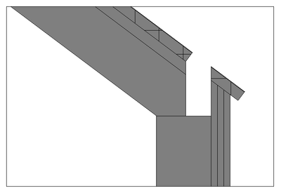

Is there a way to add a built-in gutter in a roof?
I only find a gutter in the end of the roof, which I can offset inwards but that's it.
I mean this kind:

How about if the roof only extends to the inner edge of the gutter. And for the other end, you use a Roof Coping Cap.
MostafaElashmawy
Make an opening in your roof while drawing it at the location of the gutter. the gutter tool can snap to the edges of this opening.
Mostafa Elashmawy
Why not just model it out with walls and roofs -- pretty much the way it will be constructed?
All walls and roofs:
