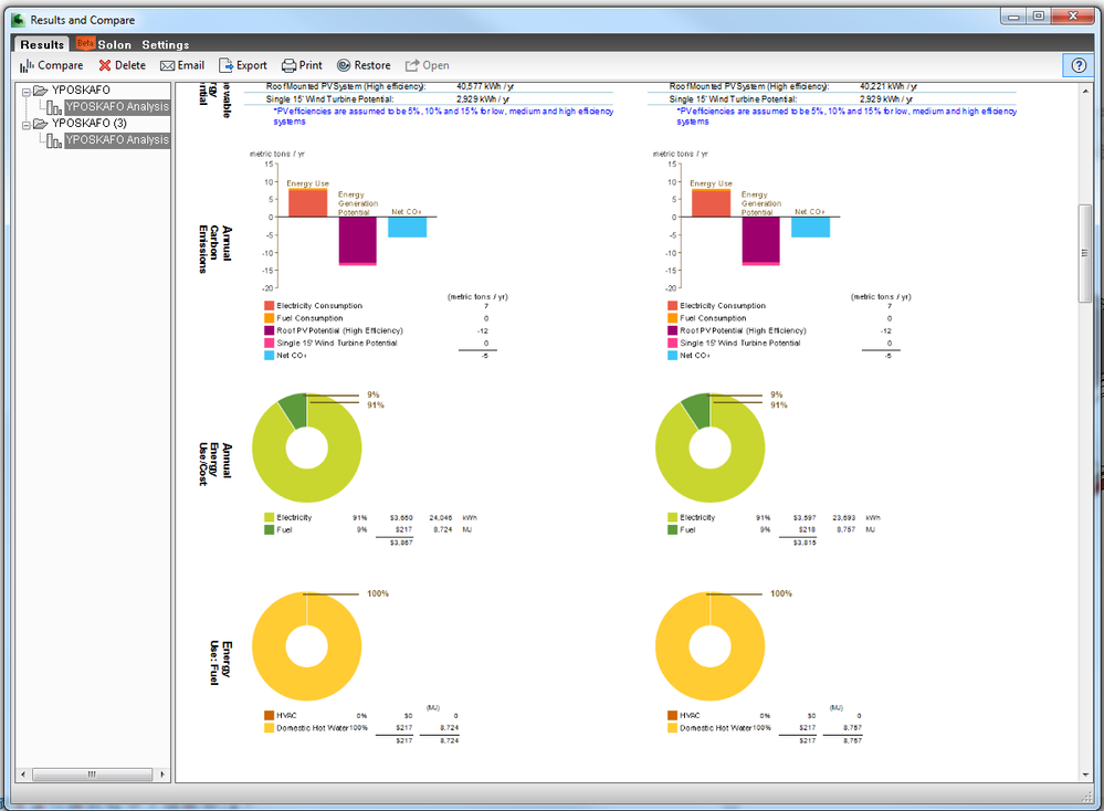

After you run the Analysis for the existing (without insulation);
  1. place the insulation and run the Analysis again.
  2. After you are done...From the ribbon, under Analyze >> Energy Analysis >> Results & Compare
  3. In the Dialog which Pops up for Results & Compare....Select both simulations and click compare and you will see them side by side
  4. Then you can Export that to PDF ...GBXML...etc
See screenshot below
