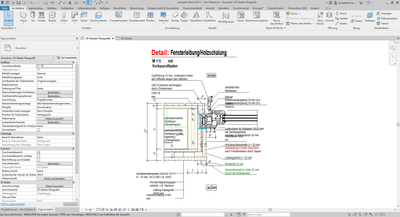

Hi!
for our team we would like to transfer a large group of standard details into Revit. What would be the best practice for this? save as groups, or as families.. how do you guys manage such assets? we cant directly use those as are from their source because hatches and dimensions need to be implemented in Revit.. the main question however is how and where to save those in which form..
Thanks!
