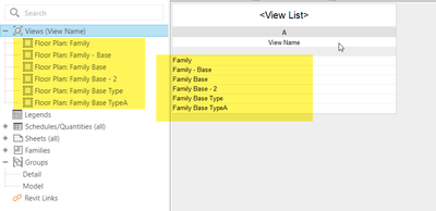

In R2022 sorting is identical in project browser and schedule ascending sorting:
