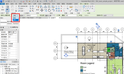

When running Revit in other languages on English Windows 10, the setting options of the 'wall' function are garbled
Update:
It happens at 'New Project' dialog as well.
[Background]
As we know, Revit can be run in other language by change the shortcut as below.
"C:\Program Files\Autodesk\Revit 2023\Revit.exe" /language CHS
I would like it shows Chinese on my laptop but end up finding 'wall' command options(Depth/Height) cannot be displayed properly.
Please refer to the pictures below for detail.
It happens on Chinese/Japanese at least, but I guess it will appears on other Non-English language as well.
Update:
Thanks @ToanDN suggested me to change the language of Win10 to test, then I found it didn't work. . Now I think Revit set locale when installed.
I think the issue is because the Windows display language of windows 10 is set to English but Revit is being showed in other language.
It happens on Revit 2020, 2021, 2022, and 2023.

Update@2022-09-15
Installed Revit2021 on Win10 with Chinese language, then switch Win10 to English, Revit shows correctly in Chinese.
But When I run Revit in English by changing shortcut, the bug appears in a diffent way as below:
most of Revit menu is English except this place, it remains Chinese:
But 'wall' command is OK now
So far, I still think it's a bug that Revit does not intend to do so.
Ideally, all characters supposed to be switch to another lanuage correctly which is super handy!
