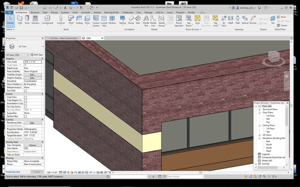

I've been working on a model of a building everyday for a week or so. I open it yesterday morning and all my brick wall color has changed to gray. I didn't change a thing from previous and all my material and appearance settings are exactly the same as they were. I duplicated Common Brick to create these. I'm completely stressed out because I have to do a rendering presentation and don't have the time to start over. I've attached pics of walls currently and previously and my graphics/appearance settings. Help please!Current WallsCurrent WallsPrevious WallsPrevious WallsGraphicsGraphicsAppearanceAppearance

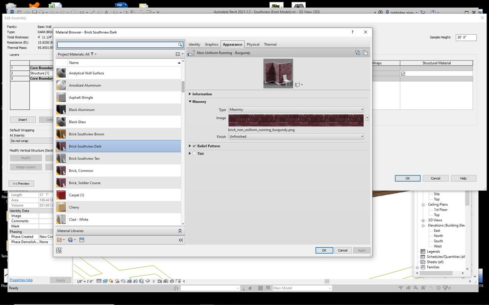

So, you are saying that the walls are not reflecting the Graphic and Appearance properties of the Material assigned to them?  Your Brick Material looks to be properly defined in your screenshot above.  You sure that Brick Material is assigned to the outer Wall Layer under Edit Assembly?
...those are not Linked Walls; right?
...No Graphic Overrides acting on the Walls in the View; right?  Such as through your Visibility and Graphics Overrides under Wall Category.

Your 3D view is in Realistic, so I think the VG override would not make a difference. The brick should still show. I notice that this material asset has 1 beside it. This could be your problem. You need to duplicate the asset. It is being controlled by another material which is likely set to grey.

For some reason duplicating the asset did work. My only issue is now I'm stuck in Use Render Appearance even though the box is not checked.

The first pic is how the red brick looks now in realistic.
The second pic is how the red brick looked in realistic view before all of this happened (originally).
Both have the Use Render Appearance unchecked.
How can I get back to how the red brick looked originally before it all turned gray. New Picture (1).jpg
