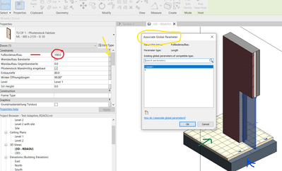

  1. consider using 2 slabs on two levels instead of 1 (1 Architectural + 2 Structural ex: Level 1 TOF and Level 1 TOS).
  2. In the project the base constraint of the wall should be set to the lower level SSL otherwise if you place on the  FFL, give a negative offset from level - in case dynamo is to be used later the latter is preferable for getting the value of the built in Base Offset from level and setting it to the parameter mentioned below (Fussbodenaufbau).
  3. When modeling the 3D geometry of the door in family editor, the frames and panel should stop at the FFL while the wall opening should be from lintel to Structural slab.
  4. In the family you need to add a  parameter for the height between FFL and Structural Slab which in this case is called Fussbodenaufbau in the below image (the value of this parameter you can either automate using dynamo or global parameters)
  5. In the family ... add a shared parameter to calculate the total height - This parameter will be tagable as you showed in the image you posted
    • (Door Height or Lintel height from level) + (height from FFL to SSL  - the parameter mentioned in point 4)
As mentioned, from this point on you have two options:
Option A: you can either use dynamo to look up the host of the door, get the Base Offset of that host and set it back to the Parameter Fussbodenaufbau in the door while the shared parameter mentioned in poiint 5 calculate the rest to appear in your tag
Option B: set X number of global parameters for the several  height variations you have then associate the Fussbodenaufbau parameter with the corresponding GP (in such case it might be better if the Fussbodenaufbau is a type parameter)
