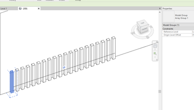

We have a vertical sweep created by one of our drafters (to create board & batten siding) that is too tall so we adjusted the batten length using the blue dot handles. We do not know any other way to adjust this batten's length (of course we can edit the batten profile). After we create an array the batten's length defaults to its original length for all copied instances in this array. Please advise how we can fix this so that all of the battens are the correct length. See the screenshots below.

What you are showing happens to me all the time with Arrays. It easily correctable by using the Align Tool.  That'll snap the line to attention.

The align tool helps perfectly. No need to share the file now, Thank you.
