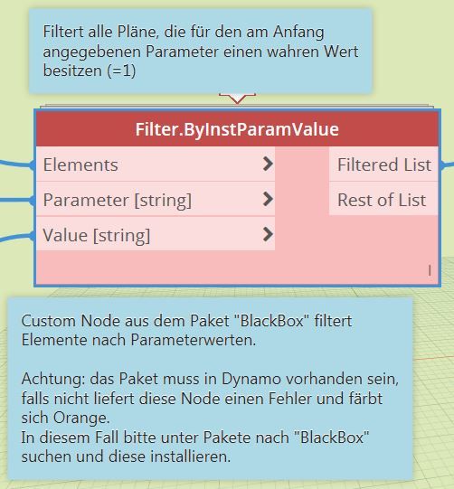

hi
something isn't right with the skript.
I get the BlackBox, but it doesn't work
Somebody any idear?

als Antwort auf: Anonymous
When a node has a red color it means it is missing.
If I look at the latest blackbox package this is correct
The filter.byparametrvalue is not part of the package.
Possibly it is deprecated in earlier versions of the package
You could have a look at a similar node from the archi-lab package (Select.ByparametrValue)
