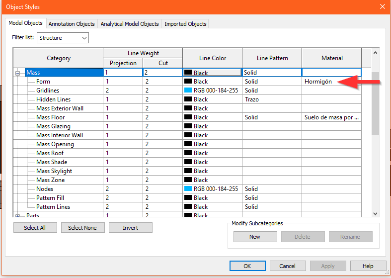

Hi all!
I'm having the next issue, I changed visual aspect of the masses of the entire Project to gray ("concreto"). Today , I've tried to draw some new masses and their color is black, only it's posible to make them gray using the option "override colours in view".
Any idea about the problem?

your photo shows obj style for mass tobe black so masses are black. yes you can right-click on them override, pattern to a solid color and change to the desired color
