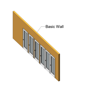

Nachricht 2 von 7
als Antwort auf: redlion120

Thank you for your reply but i want to model gypsium wall to Lod 400 I Think curtain wall will be used to make profile of stud appear
Nachricht 4 von 7
Curtain Walls and Beam Systems  - along with Basic Walls and Parts.  It's not an either/or.  There's plenty of tutorials/videos out there on the web. Google them.
...are you modeling king studs, jack studs, trimmers, cripples, headers, spacers, blocking, etc., etc.?  How about the insulation blankets between the studs?
